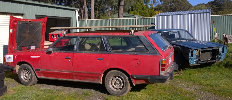

They multiply!!!!!! Very Happy Twisted Evil
Mazda 929L 1978 WP_20150530_16_35_25_Pro_zps4ptdt84z

A blue one, my favorite color !
Will you use it for parts or is she going to be a driver too ?
And it looks like another Mazda 929 Coupé, next to the building Smile
You live in a very dangerous country... Luckily we don't have any of those in France !

MessageSujet: Re: Mazda 929L 1978   Mazda 929L 1978 Icon_minitimeMar 9 Juin - 13:20
I agree.  The early model Mazdas in blue or silver are my favourite colours because they always had the blue/grey interior.
I am thinking to disassemble this car for parts - it has over 240000km on the odometer.  I have another white 929L (this one was given
to me by the gentleman who owned the green 929L) - the body is better but the interior is burgundy.  So I may change the complete interior to blue.
Otherwise, I have some spares to keep or to sell. Very Happy
The other 929 HBSHE, is my son's car - genuine 1 owner vehicle as well.  Completely original.  I wait for him to give me money and tell me what he wants
to fix/change on it, but first he must organise a safety check.  Otherwise I will do all the work, and he will do nothing! Rolling Eyes

I bought today the red S2 wagon, also for spare parts.  It has electric windows, mirrors, head light cleaners and central locking.  Also it is a 5 speed manual.
So now, I can make my green sedan a manual transmission with Luce electric upgrades. vb_dance
